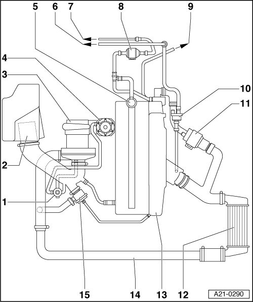

Изучаем :)
1. Charge pressure control solenoid valve -N75
2. Air-mass meter -G70
3. Turbocharger
4. Mechanical charge pressure control valve
5. Fuel pressure regulator
6. To activated charcoal filter
7. To engine control unit
8. Water separator
9. Connection for differential lock and air conditioner
10. Activated charcoal filter system solenoid valve 1 -N80
11. Idling-speed stabilisation valve -N71
12. Charge air cooler
13. Intake manifold
14. Pressure pipe
15. Overrun shutoff valve
