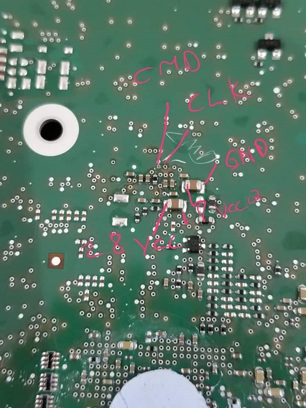

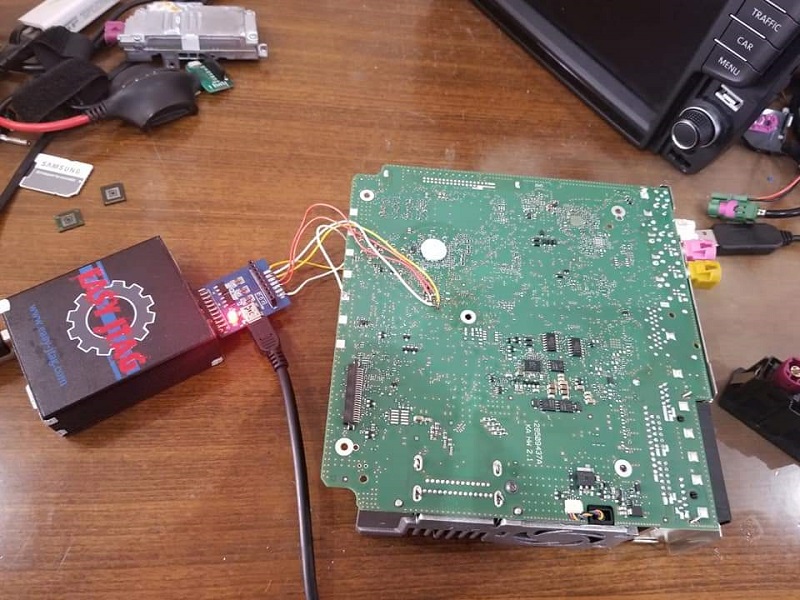

While trying to find some way of interfacing and changing the data on it, I found https://turbo-quattro.com/showthread.php?31663 and understood I could probably use JTAG to interface with it and dump the eMMC, modify it and put it back on there.
I eventually found https://www.digital-eliteboard.com/thre ... st-3919110 and soldered the cables like that.
Time went on and when I had the time to try and connect it to my (very scuffed) JTAG probe (using https://github.com/phdussud/pico-dirtyJtag/) I realized I did not know what the VCC connections on the images represented. I then read further down and the person who posted it said that they had found it on the internet somewhere else.
Could someone point me in the right direction as to what I actually need to do?
