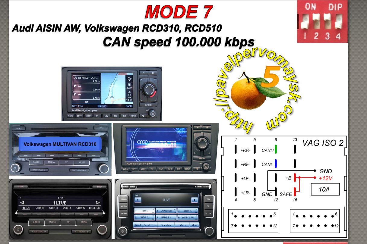

Please tell me how to "switch the ignition on" on the table? Need to check the functions of Bluetooth and some others.

U need to put some frames via CAN.

I have the CAN sender. Please, answer what is the frames?

Buy on Ali Express an Emulator

Thanks. I already solved this problem with this:
