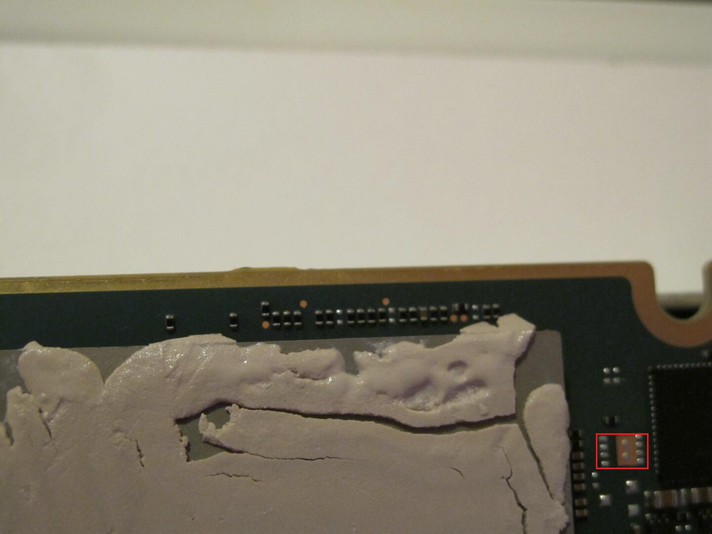

This type of jtag has been used on RNS510 - i see on MXX-board too:
https://mega.nz/file/uU9zRDYT#jr-skTbUY ... fAKqcQHB1c
Maybe somebody has connected with jtag to mmx-board on Alpine???
How read emmc - KLMCG8GESD on the board???
Maybe this place: ???
