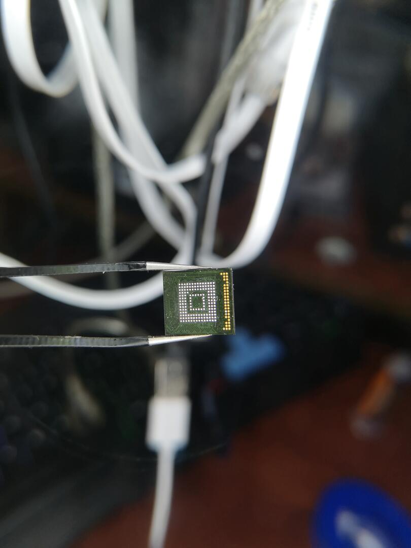

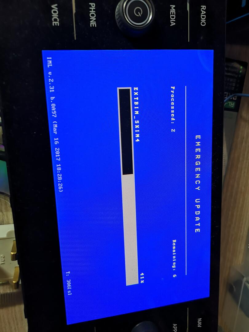

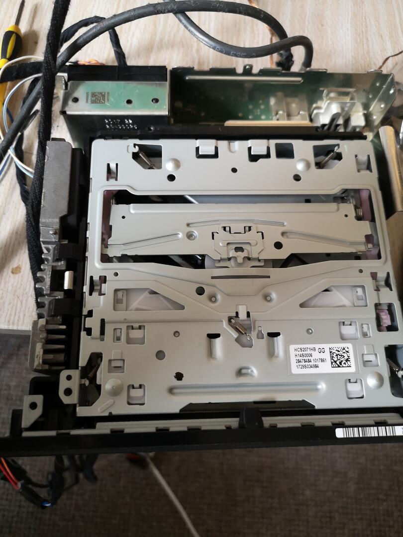

Mst2 sort it. Emmc flash it back with full working img. After that emergency update and unit works.

@volksjet Good work! How have you pushed it into emergency update? Or did it start automatically after flash?

volksjet писал(а):Mst2 sort it. Emmc flash it back with full working img. After that emergency update and unit works. [ATTACH=CONFIG]70343[/ATTACH][ATTACH=CONFIG]70344[/ATTACH][ATTACH=CONFIG]70344[/ATTACH][ATTACH=CONFIG]70344[/ATTACH][ATTACH=CONFIG]70345[/ATTACH]
How to emergency mode ? Device delphi ?

I show enough on pictures but you are not smart enough to find out. So solution what i did is desolder emmc read it by external programmer then reprogramm it. make reballing on nand which is emmc 153. Solder back. Put flash files on sd card and thats it. Hope this help you fix your units.
