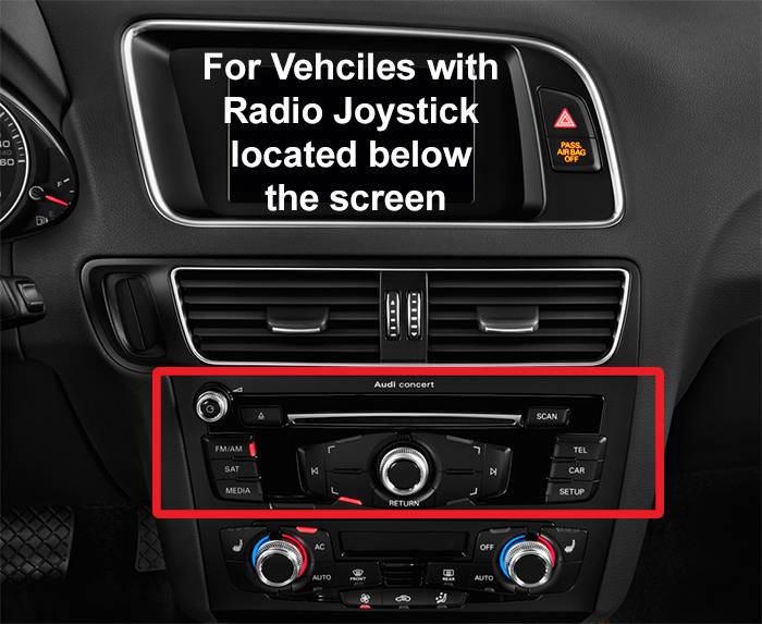

Hi all!
I have A4 8K with concert radio english language. Would like translate other language. Downloaded the radio .so fw file, have odis. But I dont know how to edit. I would like to ask for help in this.
