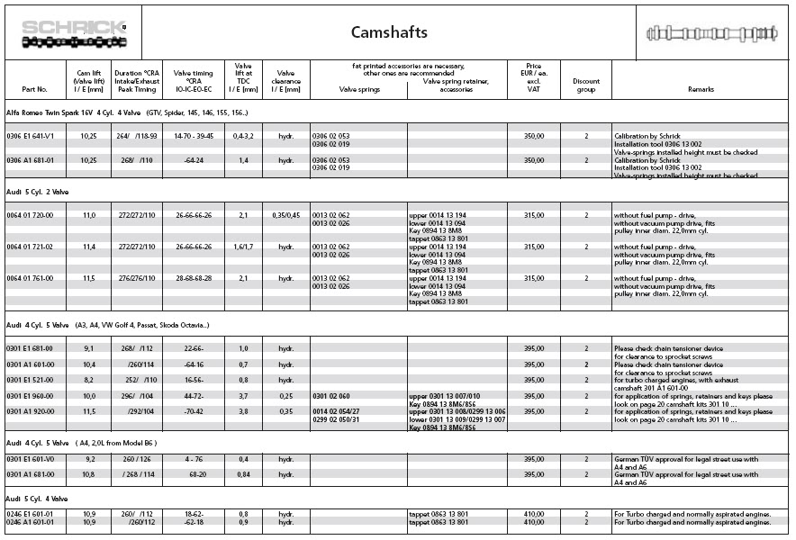

RbnTs писал(а):Ссылку дома поищу, была.
Schick выпуск 10,9 mm 62° vUT 18° vOT и впуск 10,9 mm 18° vOT 62° nUT
Проявляется - едет лучше заметно наверху :-).
это какие из них ?
partnr.
duration
duration
maximum lift
lift at TDC
parts
application
[data link]
[0.1mm+cl]
[1.0mm+cl]
[cl=0]
[cl=0]
(TURBO)
1002331
242 / 258°
213 / 224°
9.65 / 10.00mm
0.45 / 1.00mm
O.E.M.
HYDR: sport
1002303
267 / 267°
228 / 228°
11.20 / 11.20mm
1.20 / 1.20mm
O.E.M.
HYDR: sport
1002335
275 / 258°
239 / 224°
11.50 / 10.00mm
2.15 / 0.40mm
O.E.M.
HYDR: rally & cross
1002305
279 / 275°
243 / 239°
11.50 / 11.50mm
2.40 / 2.15mm
O.E.M.
HYDR: rally & cross
1002446
271 / 265°
229 / 229°
11.75 / 11.75mm
1.45 / 1.55mm
custom
MECH: rally & cross
1002440
278 / 251°
238 / 218°
11.45 / 9.95mm
2.40 / 0.55mm
custom
MECH: rally & cross
1002447
279 / 278°
243 / 238°
12.00 / 11.45mm
3.05 / 2.60mm
custom
MECH: rally & cross
1002448
289 / 285°
255 / 250°
13.25 / 12.45mm
4.25 / 3.75mm
custom
MECH: rally & race
1002450
303 / 293°
268 / 258°
13.45 / 12.75mm
5.25 / 4.50mm
custom
MECH: rally & race
1002449
289 / 279°
255 / 238°
13.25 / 11.45mm
3.70 / 1.10mm
custom
MECH: race & drag
