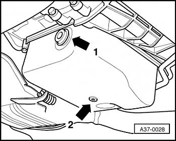

Вот описание процедуры заливки после ремонта, из Elsa:
Checking or changing ATF
Changing ATF or topping up after repairs
Notes:
◆ Observe environmental requirements for disposal.
◆ The engine must not be started and the vehicle must not be towed if there is no ATF in the gearbox!
‒ Place container under the gearbox.
‒ → Remove ATF drain plug -arrow 2- and drain ATF.

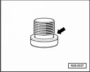

‒ → Always renew seal -arrow- for ATF drain plug.
‒ Screw in ATF drain plug (35 Nm).

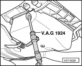

Vehicles 06.94ä:
‒ → Unscrew ATF inspection plug -arrow 1-.
‒ → Top up ATF with filler hook from V.A.G 1924 until ATF comes out at ATF inspection plug.
‒ Move selector lever to position "P", start engine and allow to run at idling speed.
‒ With engine running, top up ATF again until ATF comes out of ATF inspection plug.
‒ With brake pedal depressed, select all selector lever positions (P, R, N, D, 3, 2, 1) with engine running at idling speed, whereby each selector position must be retained for 2 - 3 seconds.
‒ Then check and top up ATF level => from page 37-45.
Notes:

Vehicles 06.94ä:

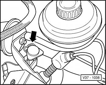

А вот процедура проверки уровня.. Щупа в машине нет, но есть патрубок под него в подкапотном. Щуп должен быть у мастеров:

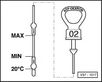

Vehicles 11.93ä 05.94:

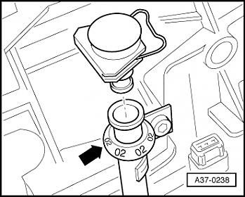

‒ → For the following vehicles, check ATF level using dipstick marked "02":
‒ All vehicles with 6-cylinder engine.
‒ Audi S4 vehicles up to Vehicle Identification No. 4A RN 033 426 ( ä about 11.93)
Note:
Vehicles requiring "02" dipstick have "02" marked on ATF filler pipe -arrow-.
‒ → For the following vehicles, check the ATF level using the dipstick marked "03":
‒ Audi S4 vehicles from Vehicle Identification No. 4A RN 033 427 onwards (about 11.93 ä
Note:
Vehicles requiring "03" dipstick have "03" marked on ATF filler pipe -arrow-.
‒ Shift selector lever to position "P" and allow engine to run at idling speed.
‒ Read off ATF temperature in measured value block for relevant gearbox version=>from page 37-47.
‒ → Pull sealing cap -arrow- off ATF filler pipe.
‒ Check ATF level when cold with dipstick "02" or "03"=>page 37-49.
‒ When ATF is cold, pull out dipstick and clean with a lint-free cloth, then reinsert into ATF filler pipe up to stop and pull out again.
‒ → Fluid level must extend up to 20°C marking.
‒ Top up ATF through ATF filler pipe with clean funnel if necessary.
‒ Allow engine to continue to run at idling speed.
‒ When ATF temperature reaches approx. 70°C, pull out dipstick again, wipe off, reinsert up to stop and pull out again.
→ Fluid level must be between MIN and MAX markings.
Note:
Note:

‒ → Secure reservoir of ATF filling system V.A.G 1924 at the highest possible point on the vehicle.
‒ → When an ATF temperature of 35°C is reached, open ATF inspection plug -arrow 1- and drain off excess ATF if necessary.
● If ATF comes out at the inspection plug before the ATF has reached a temperature of 40 °C, the ATF level is correct.
Note:
The ATF inspection plug must be screwed in again before the ATF reaches a temperature of 45 °C1).
1)50°C for tropical countries
● If no ATF runs out at ATF inspection plug before ATF reaches 40°C, top up ATF with filler hook from V.A.G 1924 until ATF comes out at the ATF inspection plug.
‒ → Always renew seal -arrow- for ATF inspection plug.
‒ Screw in ATF inspection plug (60 Nm).
