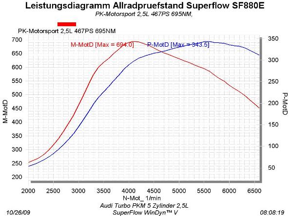

2.5L in combination with a GT3071R 0.63 A/R and PKM cam setup
2.1 bar to produce max 694Nm
1.9 bar at 467 BHP
1.6 bar red-line
+500Nm from 3000 RPM til 6000 RPM is impressive I must say.
2,5L GT3071 PKM.jpg (53.2 КБ) 384 просмотра

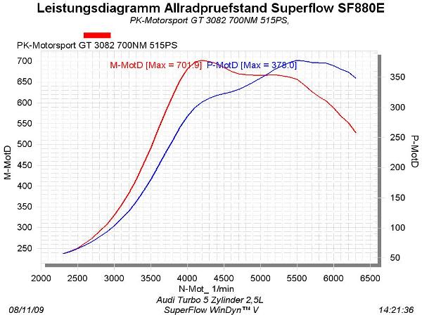

And here the 2.5L in combination with a GT3082 in 0.63 A/R, anti-surge housing, without cam overlap
2.0 bar to produce max 700 Nm
1.8 bar at 515 BHP
1.6 bar red-line
PKM 2,5L GT3082 700NM.jpg (52.2 КБ) 360 просмотров
