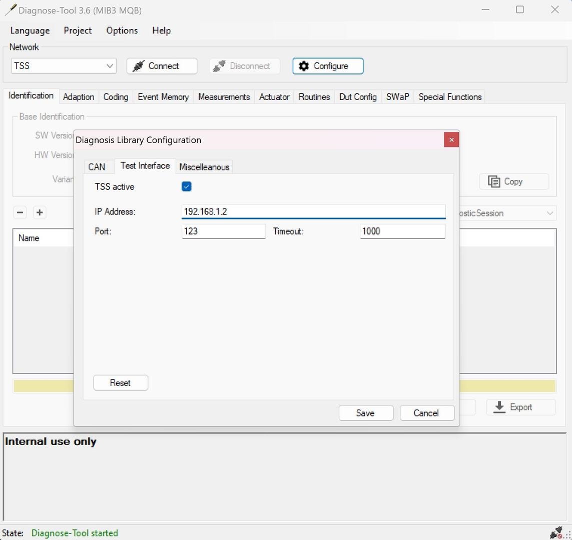

Hello guys. I am working around MHI3 activations. Some guys doing it remotely using Enet cable using Doip connection remotely. I am not sure which tool they are using. I have a software called Diagnose-Tool MIB3 published by Preh company. It has Can and TSS access option for MIB connection. CAN is being done by Pcan or Vector hardwares and TSS is being connected via D-Link car's usb port. I am not sure if it works for Swap activations because it says that in documentation, connection to company network is required for swap functions. I have tried to connect to MHI3 unit using this software but I dont know the IP address to connect using D-Link device. Does someone have any information about that software or know the IP address to connect MHI3 units?
​Here is the software I am talking about:
Вложение mib3.jpg больше недоступно

Gateway use ip-address: 169.254.170.148
hrdinaveliky
Сообщения: 47
Зарегистрирован: Пт июн 13, 2014 1:05 am
Сообщение hrdinaveliky »
IP address is in measurement value - IP4: $2ABB and IP6: $2ABC
Port: 5555
