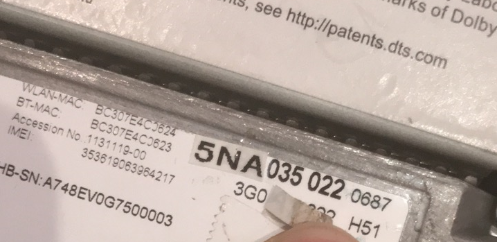

just wanted to warn you that one "big" company is selling fake 5NA units.
Attached you will find a photo of such unit.
It's actually 3G0 unit converted to 5NA.
3G0 is actually the old discover PRO2 units it's not the MIB2.5 or 9.2zoll as the Germans call it.
On of the three units that i saw in the past 1 month was with "removed" vin which suggest that it was blacklisted.
Of course all this info is hidden from the buyer. gotcha
Intentionally left the serial visible ... im sure that one forum member will recognize that module.
Buyers ... be aware, or will might end up with gold plated ring instead of golden such.
Although the module should function it's not the same hardware version.
Consider your self warned
