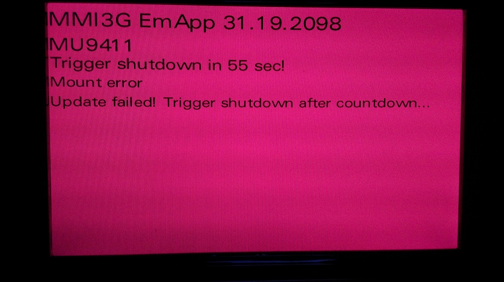

Today I have erased the headers, because I forgot doing and I think that is the reason because in the log there was:
srvstarter error: Spawning child process /usr/apps/MMI3GApplication failed! ERRN
O=12: 'Not enough memory'
srvstarter error: Spawn process '/usr/apps/MMI3GApplication' failed! Error: Not
enough memory
So I erasing the Headers:
flashit -a 680000 -e 1000
*** erasing ...
*** verifying ...
# flashit -a 40000 -e 1000
*** erasing ...
*** verifying ..
# flashit -a 780000 -e 1000
*** erasing ...
*** verifying ...
But not luck, now The Red Screen show this:
And the screen en el Emergency Mode now is black
Anybody what more to do and which is the " Metainfo CRC error "
Thank every Body

Hello everyone, good MMI has returned to life.Thanks to all who have helped me
Timur_ua
Сообщения: 118
Зарегистрирован: Ср дек 11, 2013 12:24 am
Откуда: Киев
Сообщение Timur_ua »
Hello Please tell me what you did? I have the same problem!
NANDO_A6
Сообщения: 5
Зарегистрирован: Чт июн 25, 2015 10:49 pm
Сообщение NANDO_A6 »
I use the " How-to- recover- a- bricked -Audi -MMI -3G- or- 3G - Plus" Gliana Keldo procedure is on the version.3
