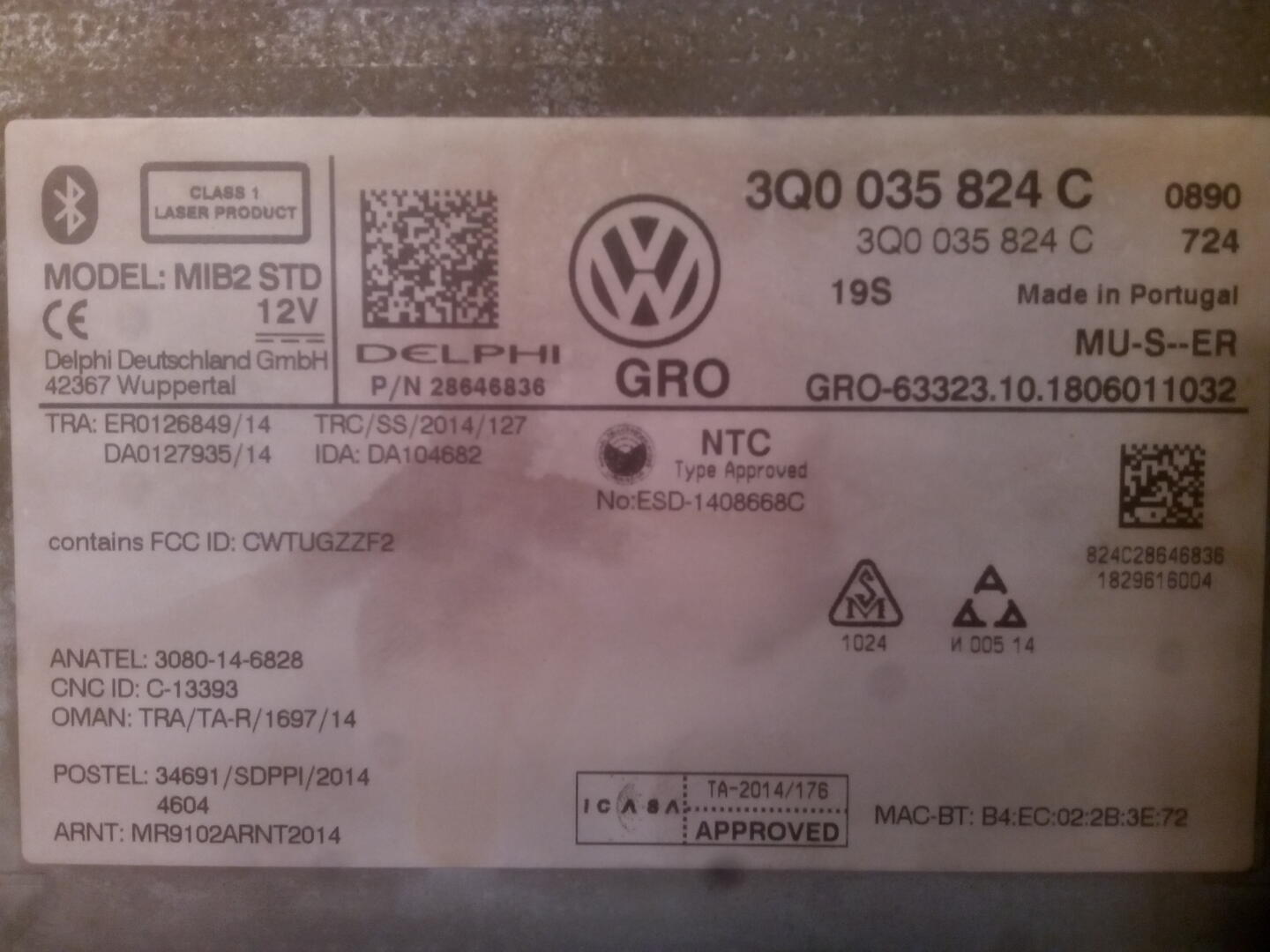

    Good day.
    Carradio DEPLHI MIB2 STD is not powered.

    EMMC inside is HBBR1 - 4Gb
    I saved an existing EMMC dump.
    Please help to determine the malfunction by the terminal log.
    If there is a dump of EMMC 4Gb then please share.
    Thanks!
