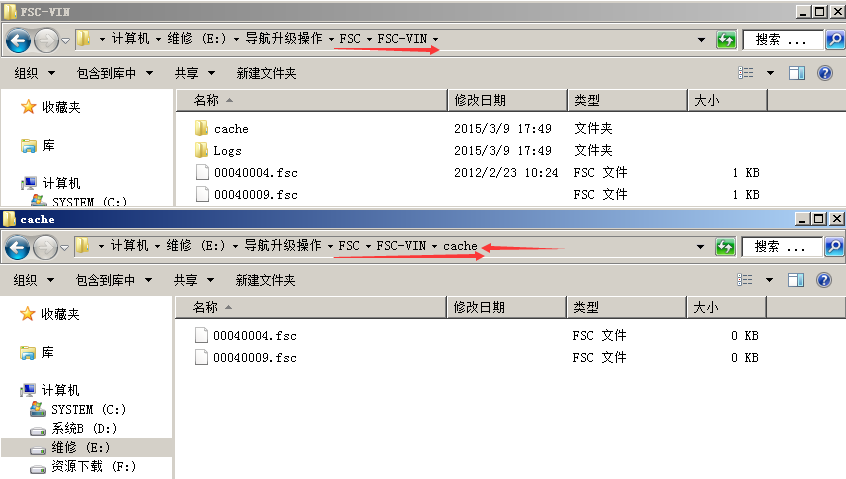

Activation failed, cannot be automatically CACHE to CACHE directory
In China some of the host can CACHE into the CACHE automatically, some are not.

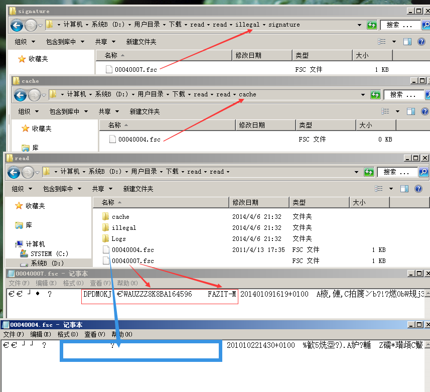

Because China's firmware, and Europe and the United States convince you such a difference?
After I pass FAZIT -m activation, and then copy the activation code for backup, and then delete the activation code in the host, use do not contain VIN file to upgrade, not in the CACHE CACHE, switch to get in front of the backup file, containing the VIN, copy the success, the CACHE to CACHE.
Everybody to help me
