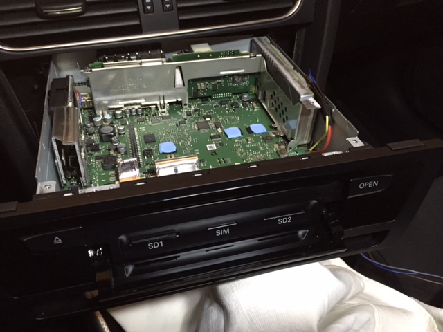

    Hello all
    I am trying to revive an MMI 3GP (8R1035670G) that probably was updated badly (I suppose an attempt to update the maps).
    The behavior is this: the central unit starts, appears for a few seconds, the Audi logo appear on the display but the button lights remain off, and after a few seconds, the hard drive shuts off (parks the heads).
    The hard drive seems in good health: it's not tickling (as a defective hard drive) and the "sound" during boot is normal, like a healthy MMI.
    In the boot log does not always appear that the disc goes off. And reading the log I don't see a reason or a particular error. It seems as if there is a timer: time passed, the hard disk starts the shutdown, end of the story. But the timer should be only working when you log in IPL.
    I am attaching two different log.
    Log2_shutdown not visible.txt
    Log1_shutdown visible.txt
    The strange thing is that when I connect with IPL do not see the red screen (AppFPGA): the MMI display is completely off.
    I tried to manually flash the firmware (fw 614), writing the memory block headers one by one (using flashit commands), but nothing change.
    I also tried to install the firmware in "automatic" (deleting the FPGA and IFS-root block headers and restarting with the SD card inserted). The green screen appears and the flash process starts, but when the system should reboot (step 6/8), system reboots from the hard drive, and then after a few moments the hard freezes, as always.

    From the inside of MMI, I see sometimes a little red light inside the MOST port, but I don't know if it is the signal emitted by my car (IN) or the signal emitted by the 3GP (OUT).
    Any suggestion?

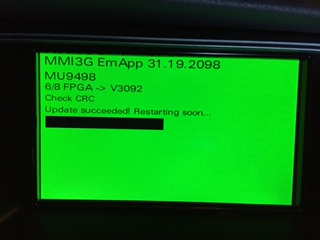

    The reason for the "green screen" in the emg recovery mode ist quit simple: you have entered the "Developer Mode command" befor.
    lets see your log:
    ******** DeveloperMode is on ******************************
    Disabling IOC watchdog
    There was a file written on the efs-persist image to stay in dev mode until the machine starts ok.
    Thats not a problem. The emg-recovery will work fine, normally.
    Try it with the correct firmware for your MU 9498 machine in the EU: K0767 in SD-Slot!

    Hello
    I try to fixed a bricked Main Unit.
    The Unit have the PartNumber 8R1035666.
    I think the Image fs0p3 efs-persist.efs is broken.
    If I start the Unit in normal Mode or in IPL Mode
    the unit boots first quite normal,
    but then runs the here all the time down
    I tried to manually flash the firmware (fw 767), writing the memory block headers one by one (using flashit commands), but nothing change.
    I also tried to install the firmware in "automatic" (deleting the FPGA and IFS-root block headers and restarting with the SD card inserted). The green screen appears and the flash process starts, then it stoped by erase and do nothing!!
    I have extract a efs.persist.efs image from a funcionally unit.
    I have try to flash the efs-persist image but if i go to emg app with the command boot 1c0000
    the unit boots at first, but after
    SWDL: Starting EFS driver (automount)
    result of running command start_efs_driver.sh is 0
    came this failure (see picture top)
    I can not start to reflash the efs.persist image because this failure
    Sorry for my bad english
