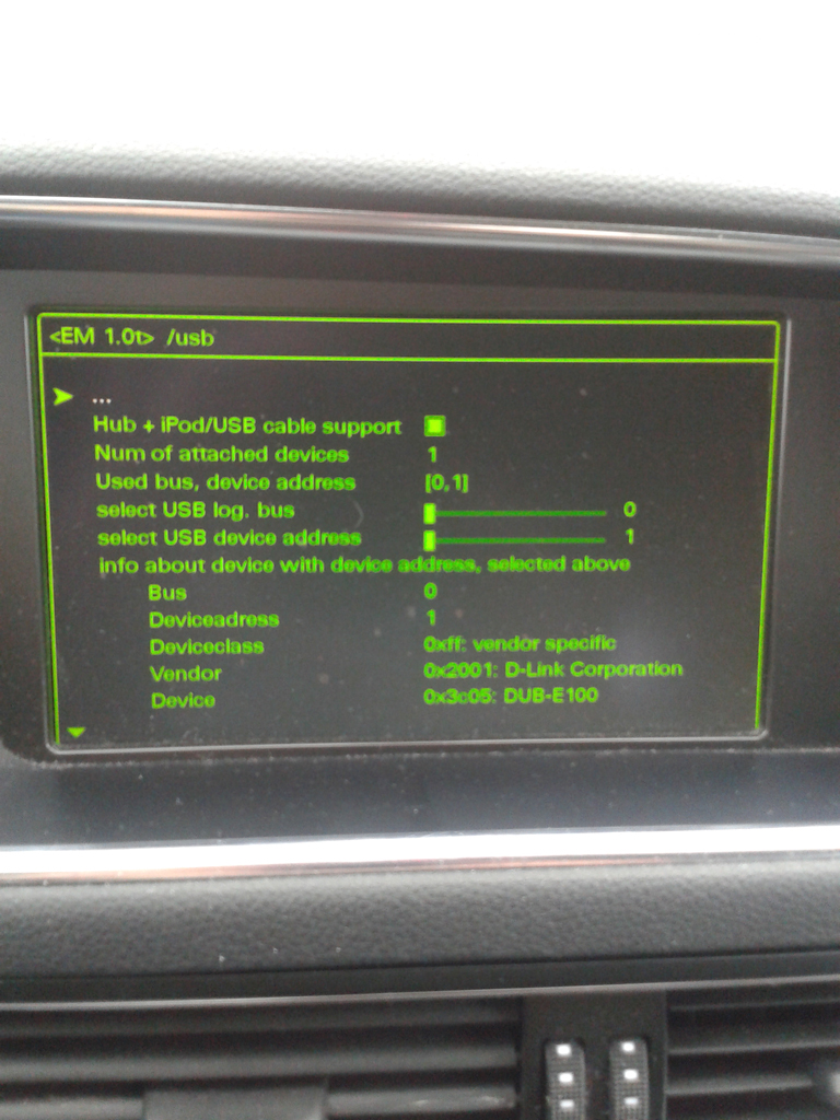

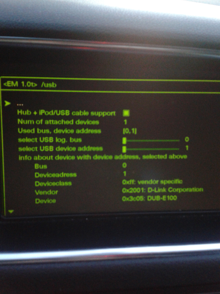

    Following the advice of Sergey I connected the ami->usb to dlink dub e-100 rev B1 and then dub e-100 to tp link 3040 (with rj45).
    I enabled wifi router in my android phone and then I configured the 3040 as wisp client (connected to wifi of my android phone and to dub e100 with rj45).

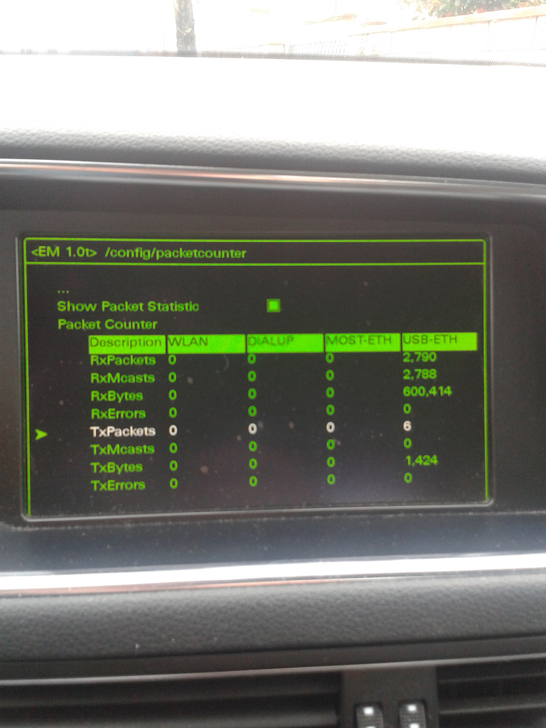

    I see the tplink 3040 as client in my android phone but if I select google earth in navigation nothing happens (in 3040 control panel I don't see any packet from dlink even if I see tx/rx lights in e100).

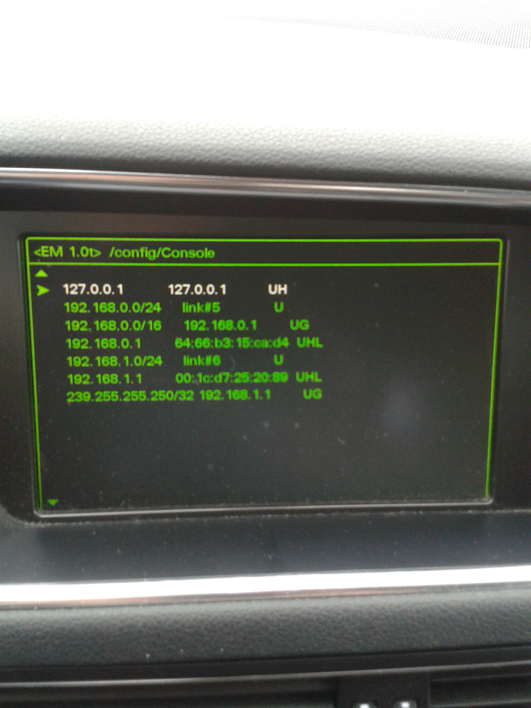

    I see that 3040 gives ip as 192.168.0.X (X>100) while my android phone router in range 192.168.43.X.
    The routing tables of 3040 seems ok because with my pc connected with wifi to 3040 I can navigate.

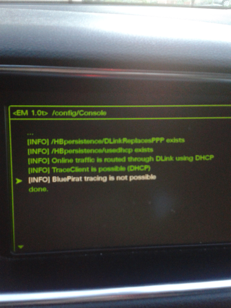

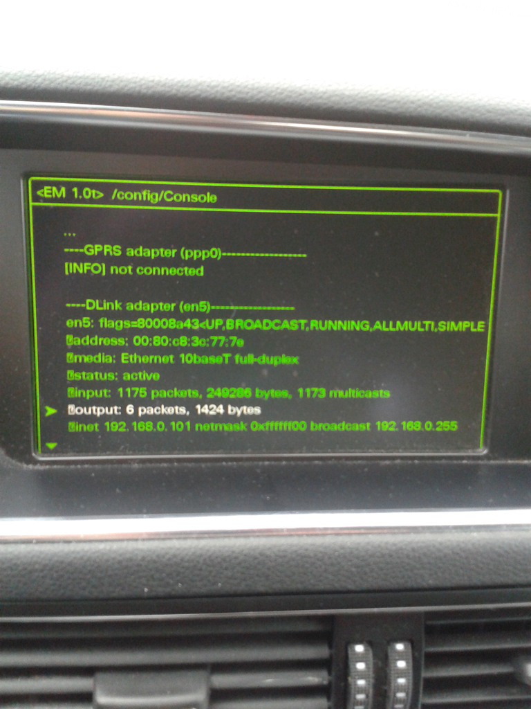

    I clicked on "Install Fair Mode" in hidden menu: the output was shown in the screen and it seems that it did some backup file and then he created dhcp and dlinkreplacePPP.
    Then I rebooted but the result is the same: the google earth remains in onloading and it is no possibile to connect to audi connect.
    I attach some screens of hidden menu.

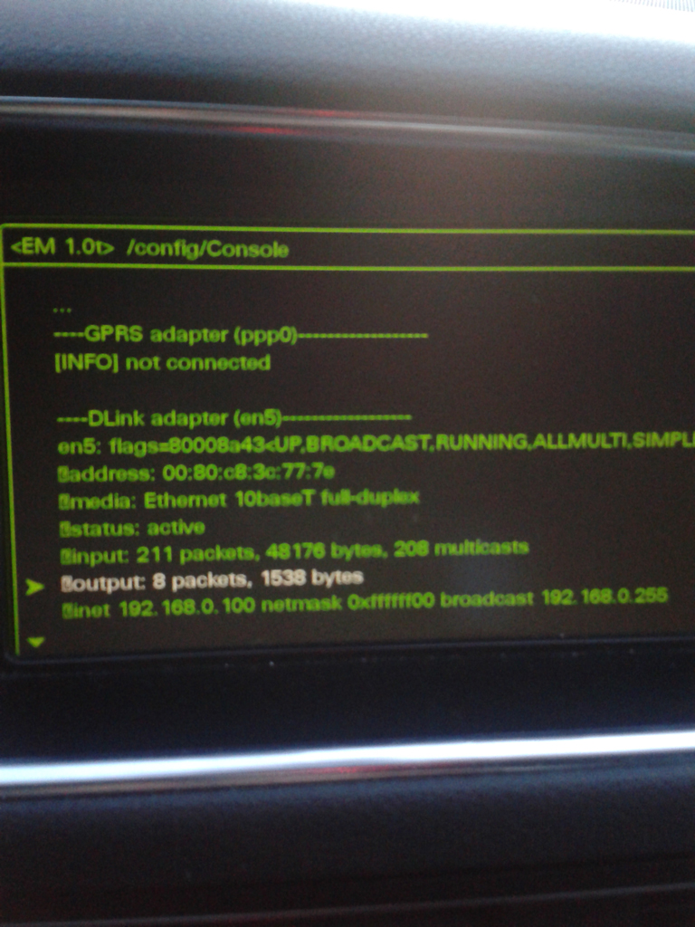

    Tplink seems to give the ip 192.168.0.100 to dlink (see image below): if I see this ip is it possibile to think that dhcp of tplink 3040 is working well?
    Is this ip correct (for internal routing table) to route packet from MMI to external router android?
    Looking at adapter page it seems that dlink is known as 10 full duplex link and not 100 full duplex link: is it correct?
    Maybe my ami to usb cable is not so good and I need a more quality cable to support 100 Mbit speed.
    (the ami connection is ok because I tried to connect a usb pen and it is ok).
    What should be the problem?

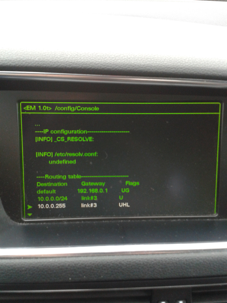

    need up DNS
    manual DNS setup. touch in efs-system/etc/resolv.conf
    inside file
    nameserver 123.123.123.123
  6. #6

    echo nameserver 123.123.123.123 > /mnt/efs-system/etc/resolv.conf
    IP DNS set correct !!

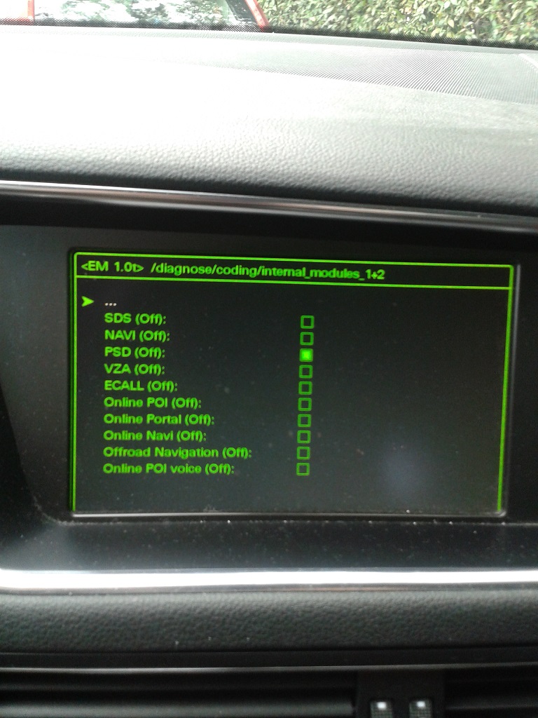

    Anyway I have no TMC online menu.
    If I go to tmc info page in MMI, I don't see any line with "Online traffic data".
    In the hidden menu in internal_module_1+2 I have PSD Off selected.
    This is my conf:
    Is the error PSD Off?
    Do I have to deselect it?
    Thanks very much

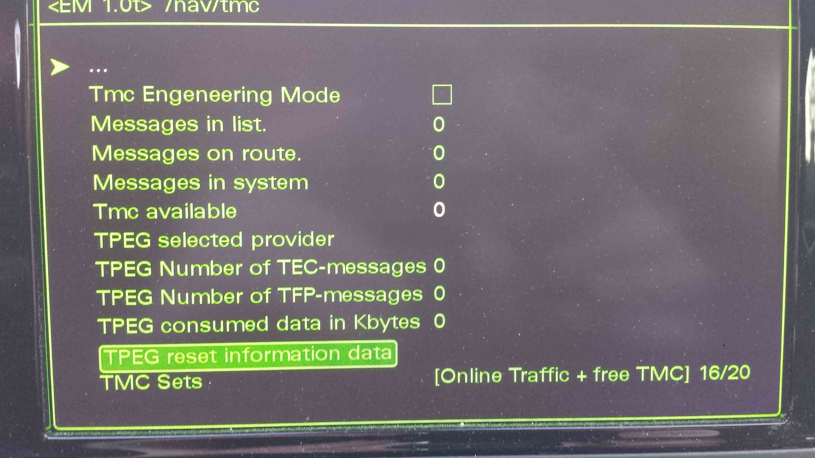

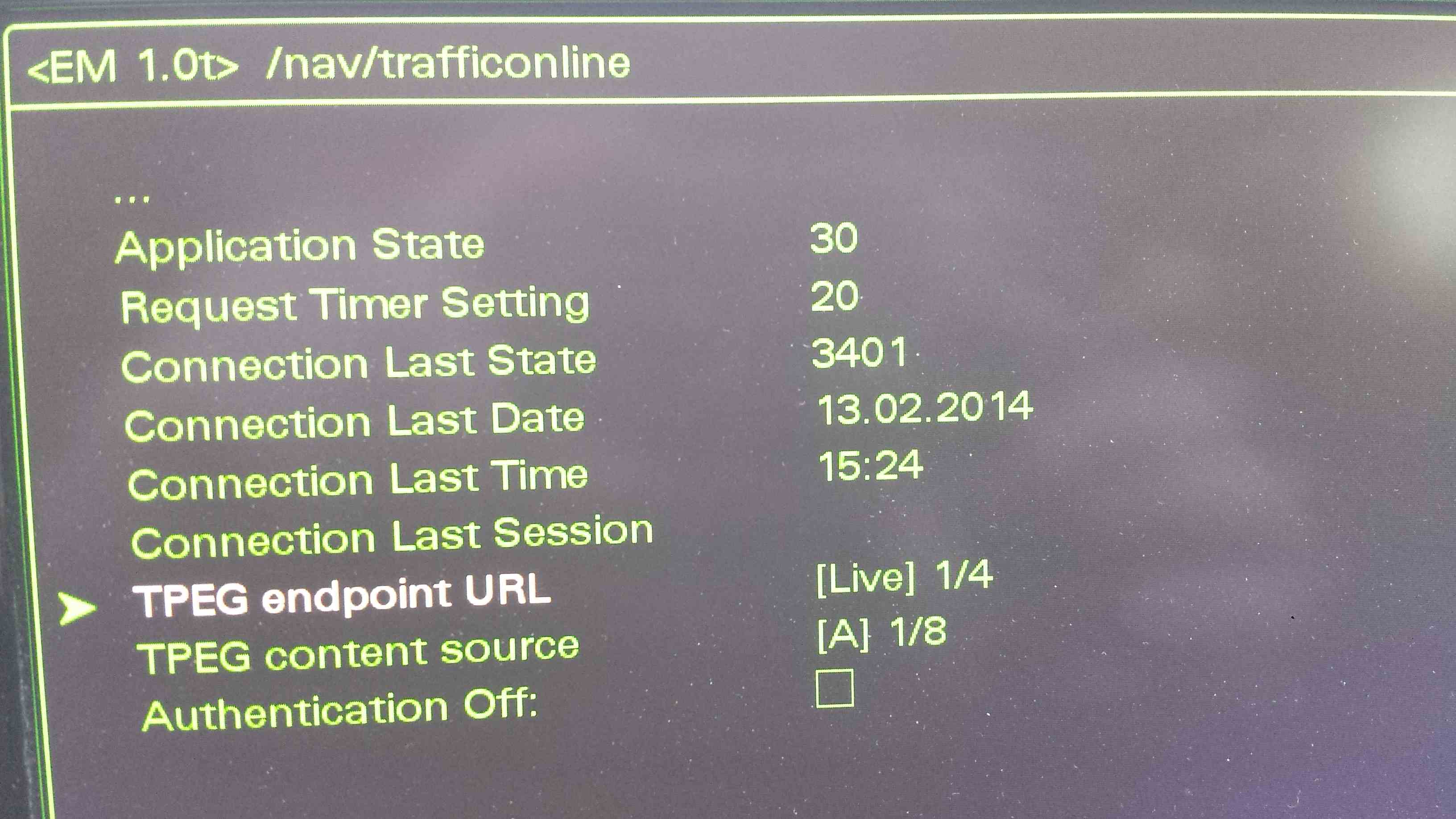

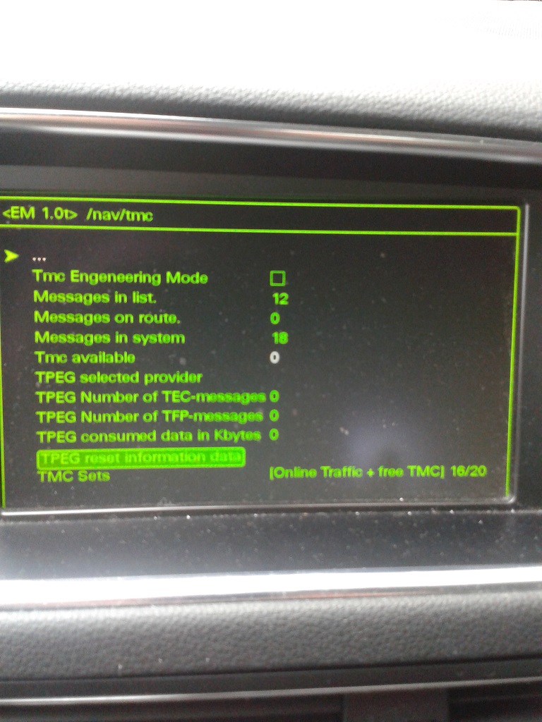

    I found in the hidden menu a part about TMC which I had as undefined.
    I tried to set as online traffic + free tmc but nothing happens: no voice "Online traffic data" in info settings page.
    Could you tell me exactly which values to set?

    Hi Sergey I read that for traffic online is important channel 69 of unit mmi: is it true?
    Do you know what value should it be set?
    Thanks
  15. #15
    Регистрация
    17.01.2007
    Сообщений
    4,012
    По умолчанию
    69 Ch 15Bit (+32768)

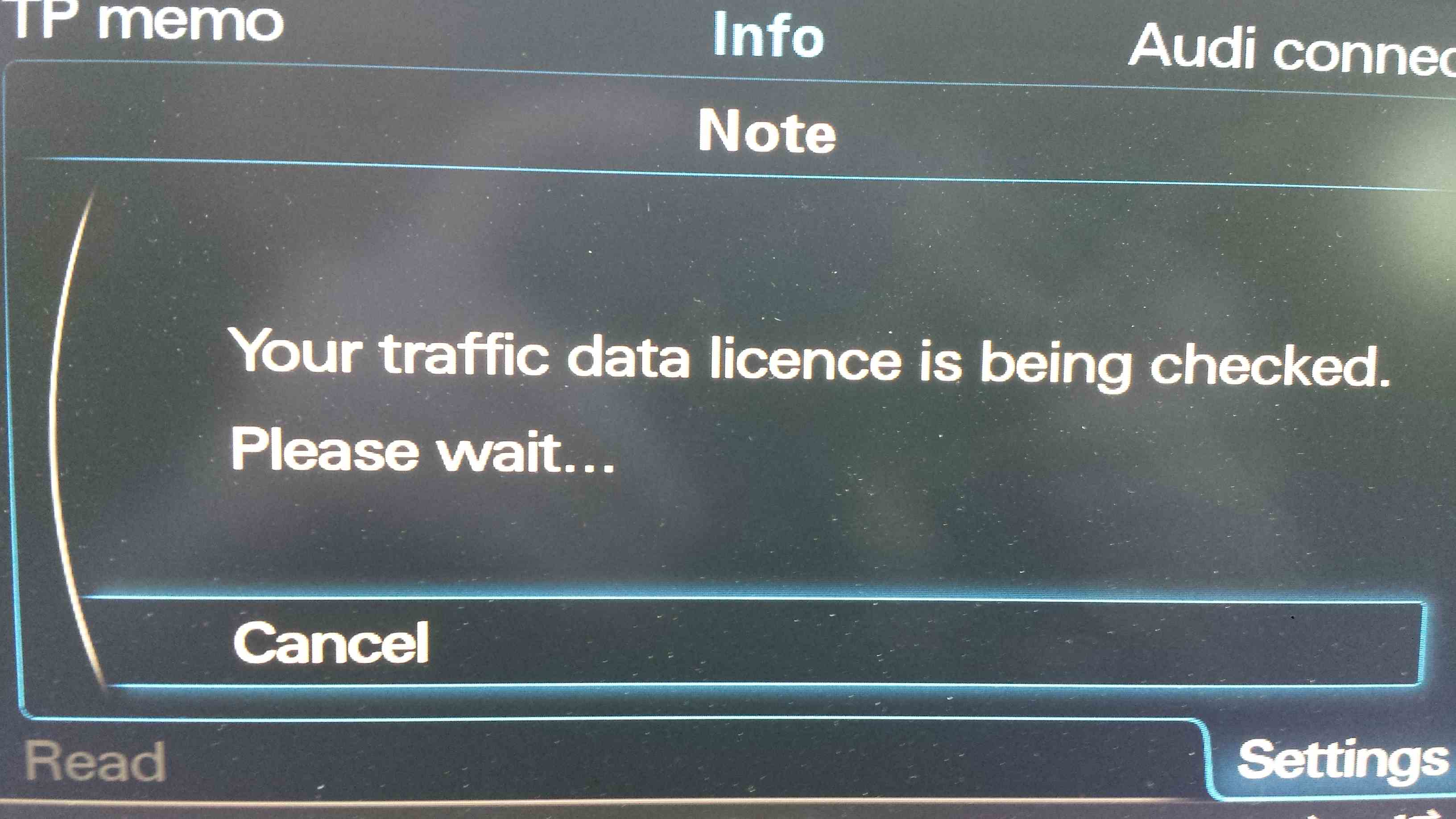

    To enable online traffic you have select "Online traffic data" to yes and after connecting to audi server, the licence will be activated for 3 years.
    After all I attach some screens of what you will have:
    but when I am checking license all the time I got answer - currently the query cannot be processed.
    any ideas whats wrong?
    I had not traffic online factory installed - I added it by channel 69 where I set value 32783. then I got in menu traffic online but impossible to add licence
    even I asked about audi - their answer was as usually - this feature existiing from W45 2012 and impossible to add later
    pls help me - I am fighting with this since begining of 2013
    my current version SW is 770 but same issue I had with 612, 614 and with 518_7
    I have screnshots from green menu and others but I am not able to upload anything to this forum
    if I will swap 5F to another one it will works? if yes whats a problem that mine doesnt works?
