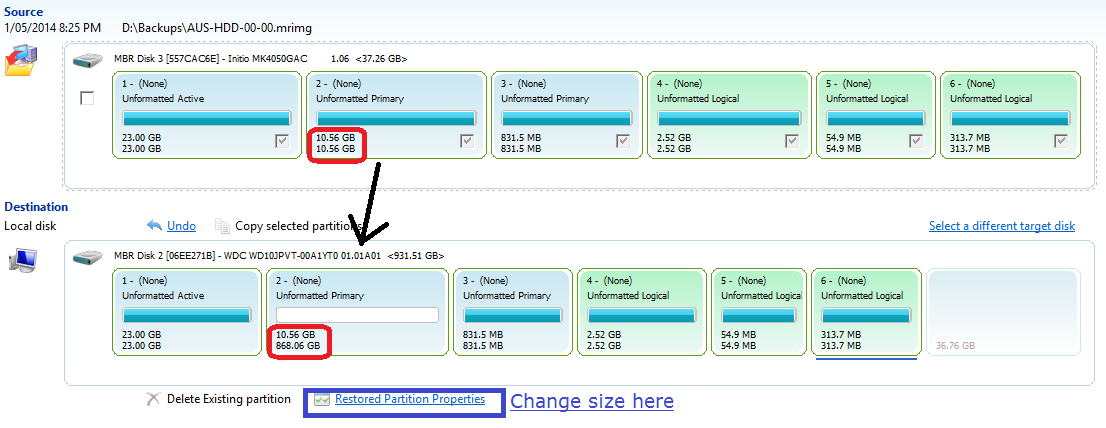

Hi All,
I have now performed this "HDD Upgrade" procedure MMI 3G Plus units several times in the last few months and it works like a charm:
1. Download macrium reflect free edition.
2. Remove the original Toshiba HDD from the MMI unit.
3. Connect the drive into IDE<->USB connector
4. Clone the drive into an image using macrium (Forensic method)
5. Disconnect the original drive and insert a bigger drive (you have 3 choices: Normal IDE HDD (not recommended) / SDXC SD card in IDE Sleeve (Good) / IDE SSD (Best))
6. Restore the image into the drive, one partition at the time.
7. On the second partition re-size the destination partition to expand to the remainder of 'new addition' space
8. Restore the rest of partitions.
9. Connect the new drive into MMI unit
10. Jukebox is now not working, so go to Setup -> Settings of MMI -> Reset and Select Jukebox.
11. Reboot MMI and repeat step number 10 again.
12. Final reboot.
13. Jukebox is now resized, the rest of the systems are all working ok.
I hope this helps!
Regards,
Keldo Gliana
MMI 3G has 6 partitions -- read more here: http://www.scribd.com/doc/221492426/...ive-PartitionsЦитата:
How many partitions original HDD has?
MMI 3G Plus has 8 partitions.
Вложение 27268
Yes - for both, MMI 3G and 3G Plus you need to expand the second partition.Цитата:
expand the space of partition no.2 (jukebox)
Expand to the remainder of 'new addition' space.Цитата:
To the rest of space according to new drive volume. Correct?
See this photo:
Вложение 27269
